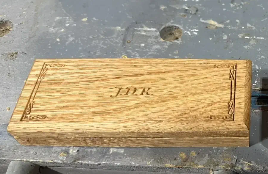

Choose a layered, fitted or hinged wooden case
Explore a foam-lined beech case, a fitted oak case and an oak case with barrel hinges and magnets.

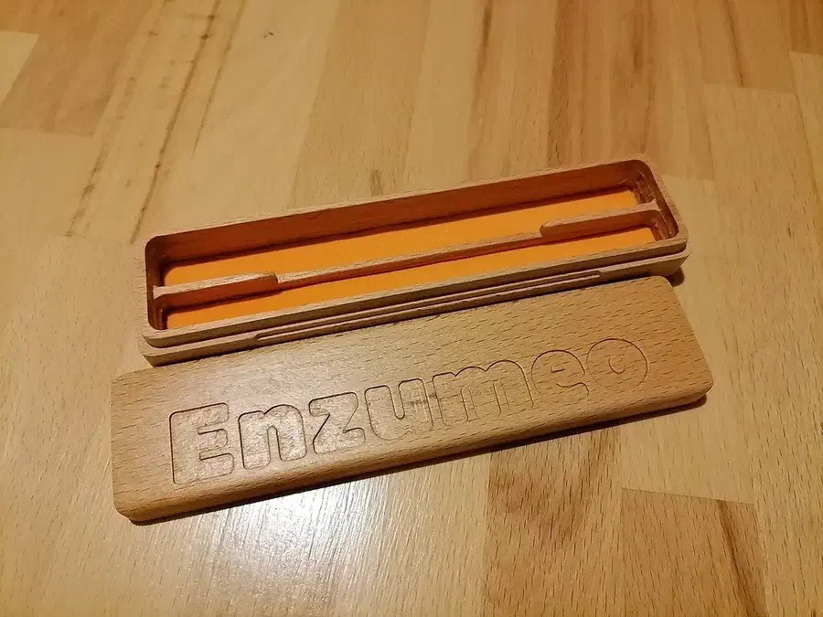

Leave the outside rounding until the layers are glued
Antonello rounds the corners with a plane after gluing his beech strips together. He then uses a belt sander and 240-grit paper during finishing. Shaping the assembled stack helps the layer edges meet as one case. His orange inserts are separate 2 mm foam pieces, so leave room for that lining when adapting the interior.
Project notes by Antonello Santi: read the source.
From PencilBox Enzumeo by Antonello Santi.

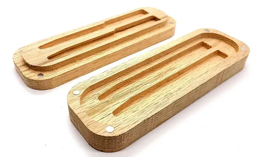

Mirror the inside layouts of a hinged pair
Vincent says to mirror the top and bottom when carving so they match. That matters when the two halves open around barrel hinges: the recesses need to face one another when the case closes. Keep the hinge and magnet locations paired as you adapt the pocket layout. The hinges and magnets are bought parts, not pieces carved from the lid.
Project notes by Vincent Bonina: read the source.
From Pencil Case by Vincent Bonina.
