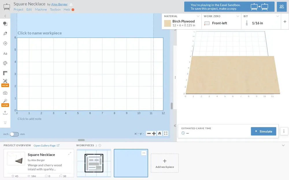

Start from a blank workpiece
Draw a round pendant with a hanging hole
Start with a blank workpiece and add a circle 1½ inches wide. Set its cut to follow the outside edge. Add a ⅛-inch circle near the top and set its depth through the ⅛-inch stock shown in the preview. Watch the real Easel editor and 3D view update. This demonstrates the pendant shape and hole; choose a chain or cord and adjust the design for your own material before preparing the cut.
A real blank Easel workpiece gains a circular pendant outline and a smaller hanging hole beside the native 3D preview.
Recorded in the Easel editor, shown at 3× speed.

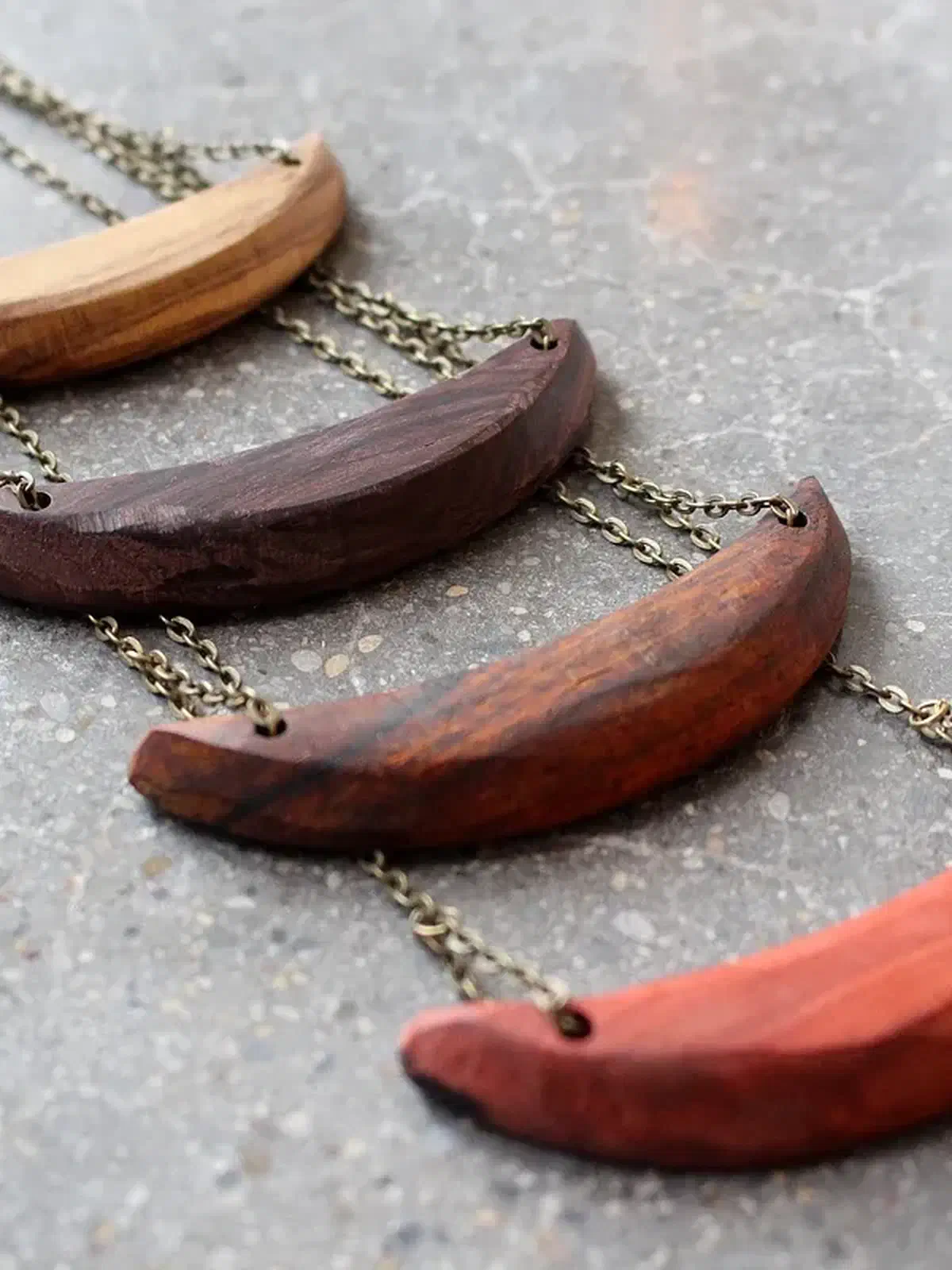

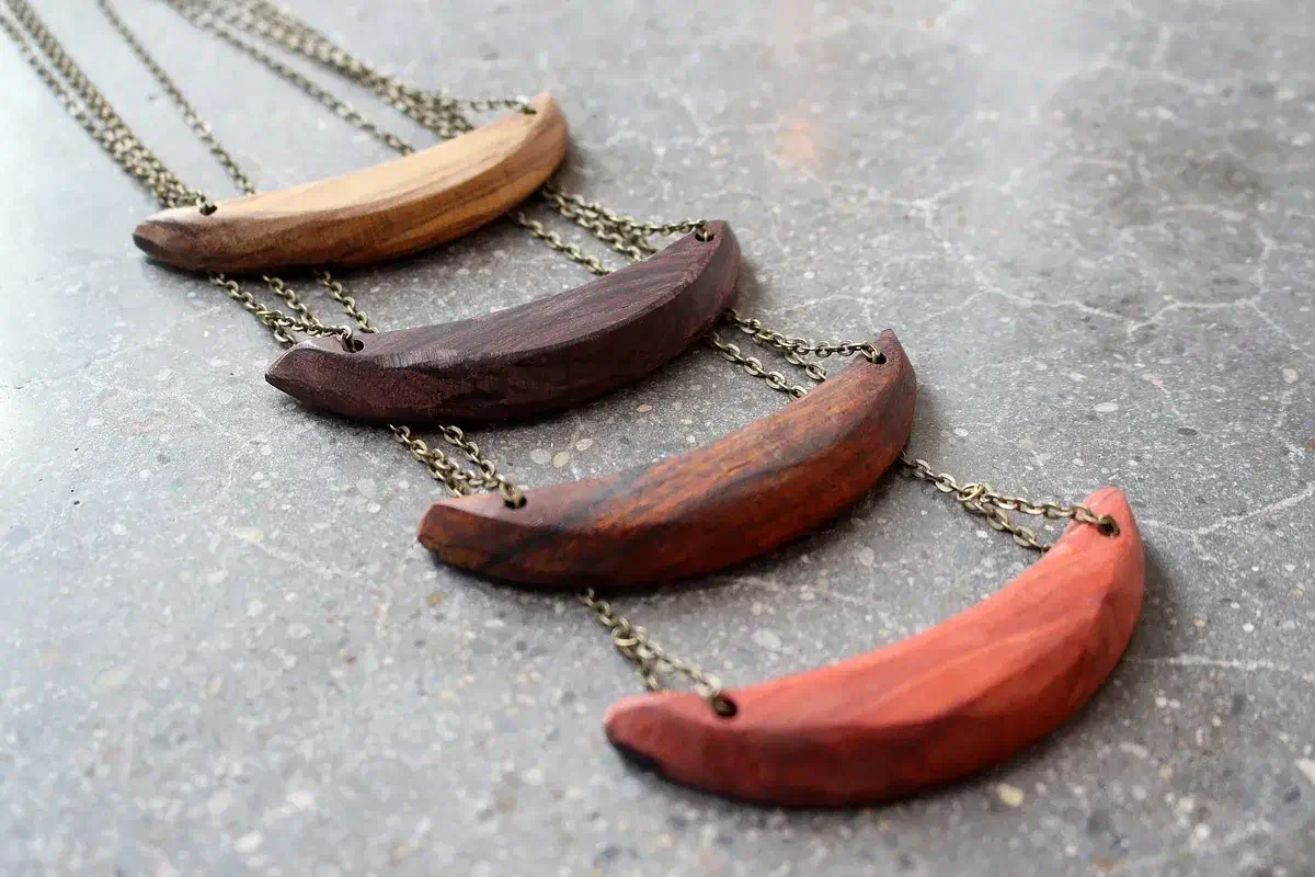

Carve a crescent, fit metal inlays or make matching charms
The wood shape is only part of a necklace. These makers show different ways to add detail, attach a chain and finish the piece, with shared designs for the carved parts.

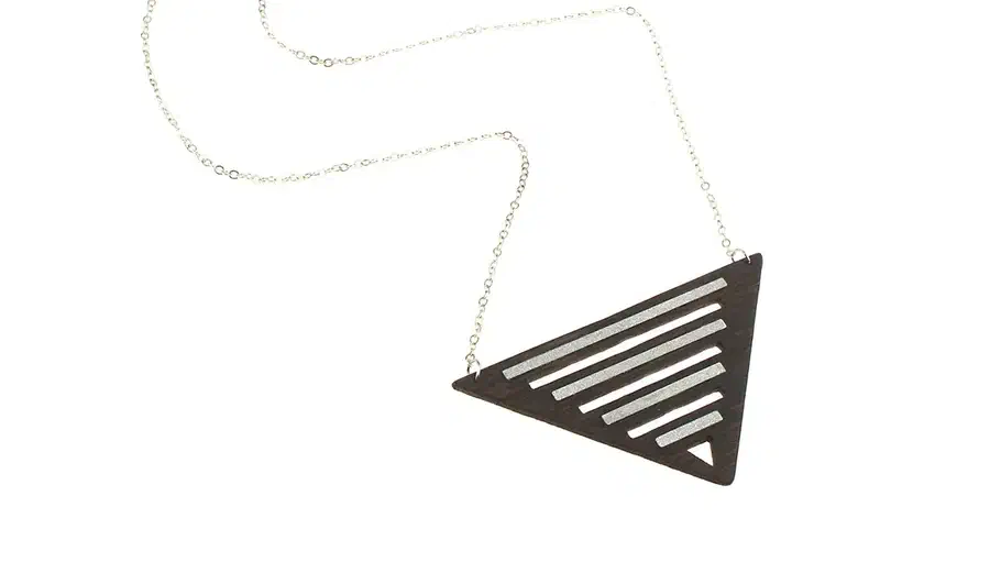

Leave room below and around each metal strip
Berger used aluminum about 0.02 inch thick and cut the pockets 0.03 inch deep so the strips would sit below the wood surface. He also made the strips slightly smaller than the pockets and filed their corners to match the cutter’s rounded corners. Test one strip before making the rest.
Project notes by Alex Berger: read the source.
From Inlay Necklaces by Alex Berger.

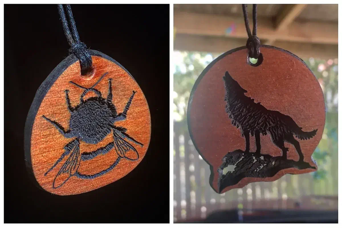

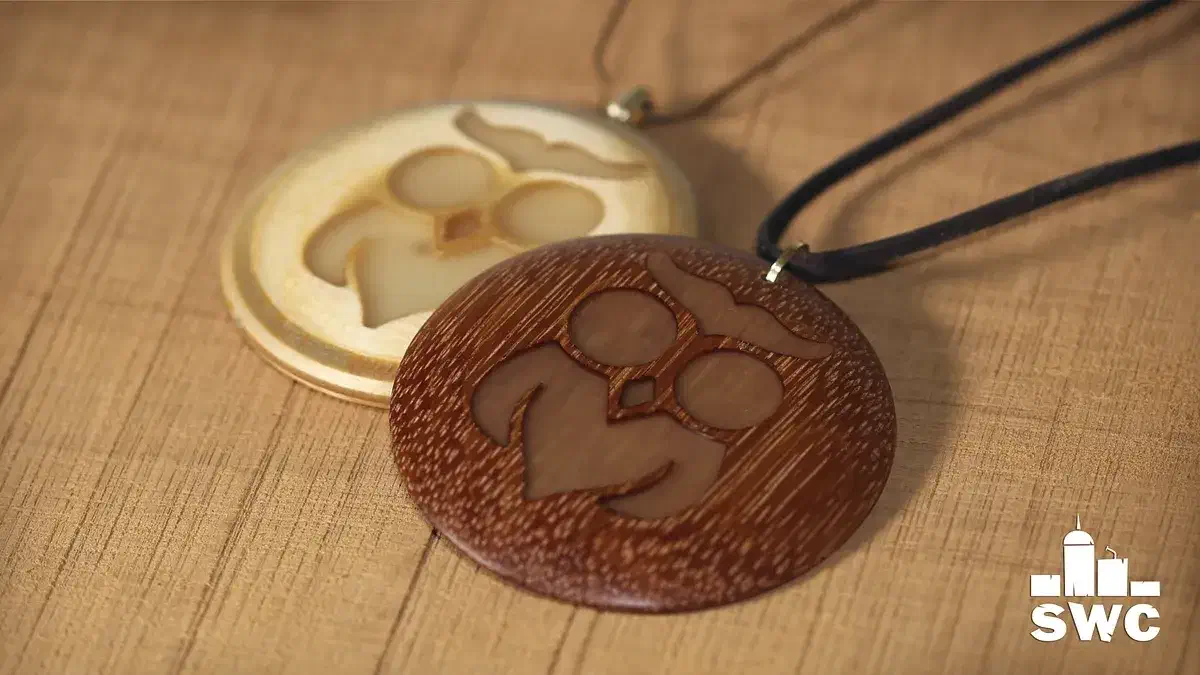

Paint the carved detail before the clear finish
Brennan painted the recessed bee and wolf details matte black, then applied a satin clear finish. That order keeps the color in the carved design and puts the final clear coating over both the wood and painted areas.
Project notes by Brennan: read the source.
From Fury Bee And Wolf Necklace/Hangers by Brennan.

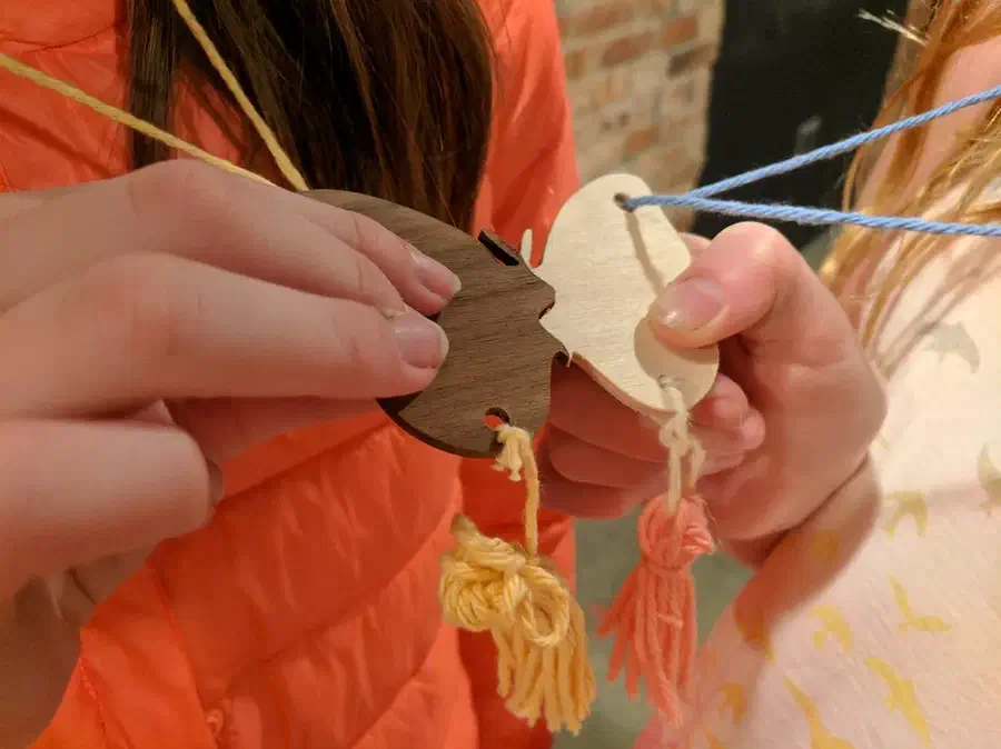

Keep small antennae thick enough to handle
Ruble notes that the butterfly antennae are fragile at this small size. If you resize the charm, look at those narrow parts as well as the overall width. You can thicken the antenna or simplify its tip if you want a sturdier necklace.
Project notes by Chad Ruble: read the source.
From Butterfly Friendship Charms by Chad Ruble.
