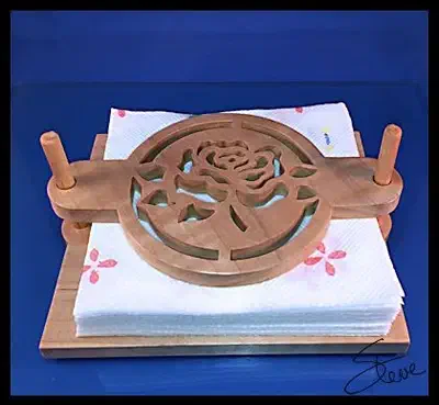

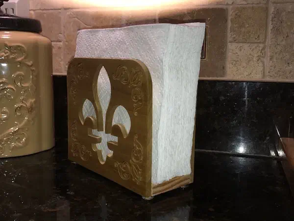

Stand napkins upright or keep a stack flat
Choose a slim counter holder, a stand with room for condiments or a flat top that rests on the napkins. Each project links to its maker’s shared pattern.
See more napkin holder search results →

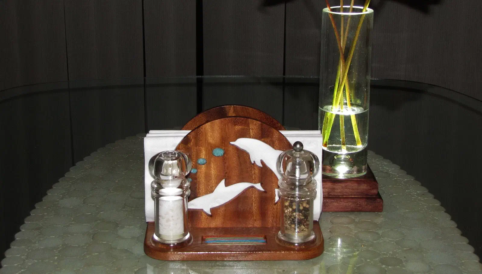

Make a holder for your table
Start with carved poplar sides, a dolphin stand or a flat rose-cutout top. Adapt the shared pattern to the size of your napkins and the space on your table.
