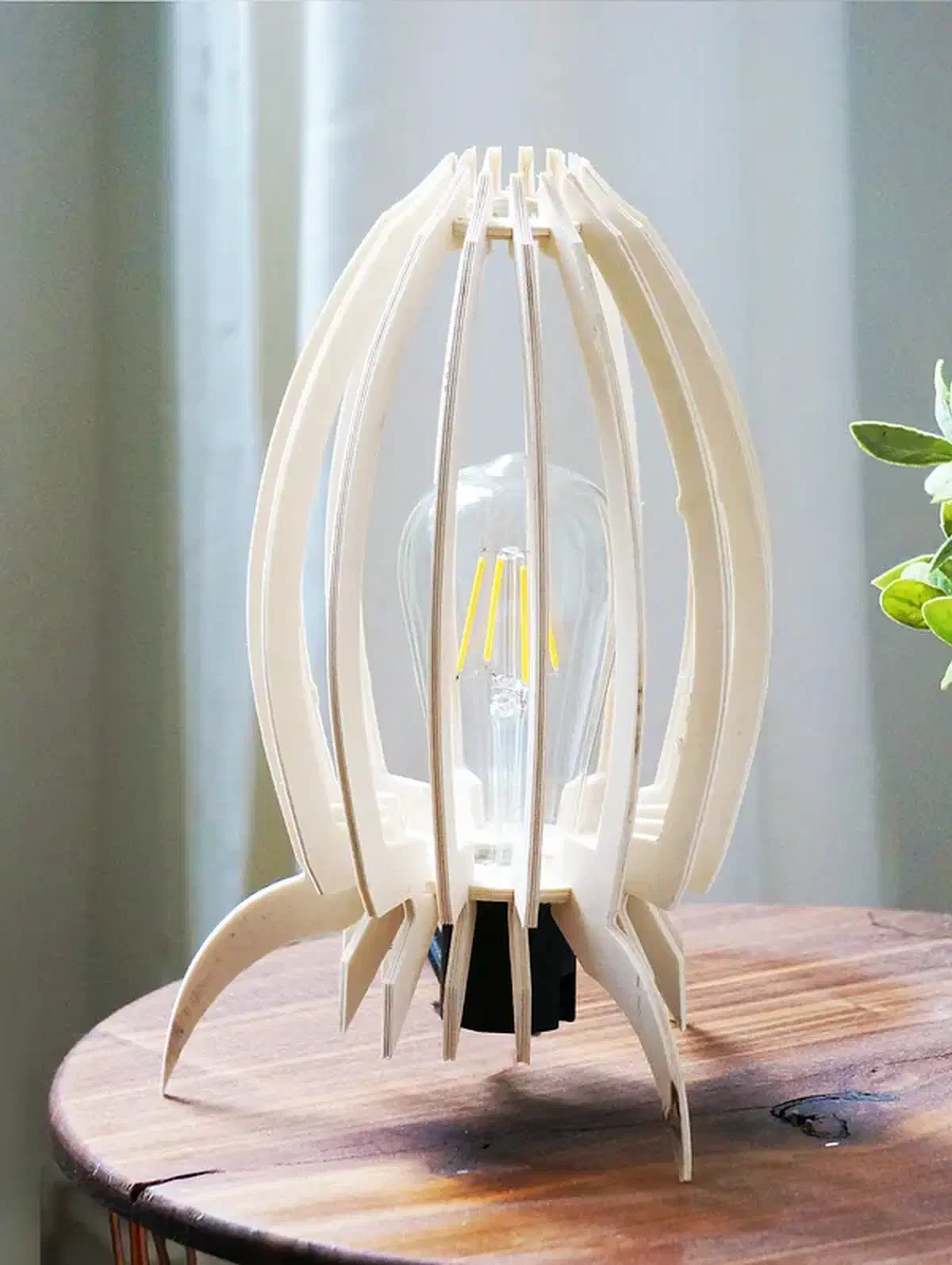

Build a desk light, a hanging shade or a wall lamp

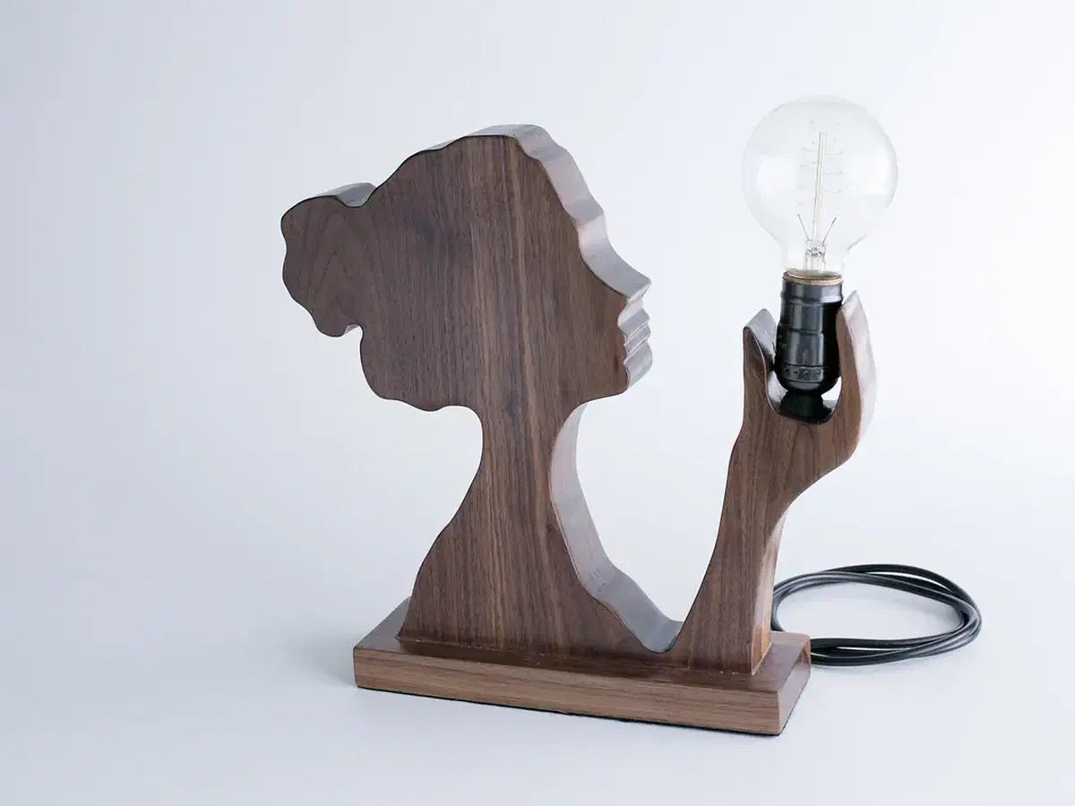

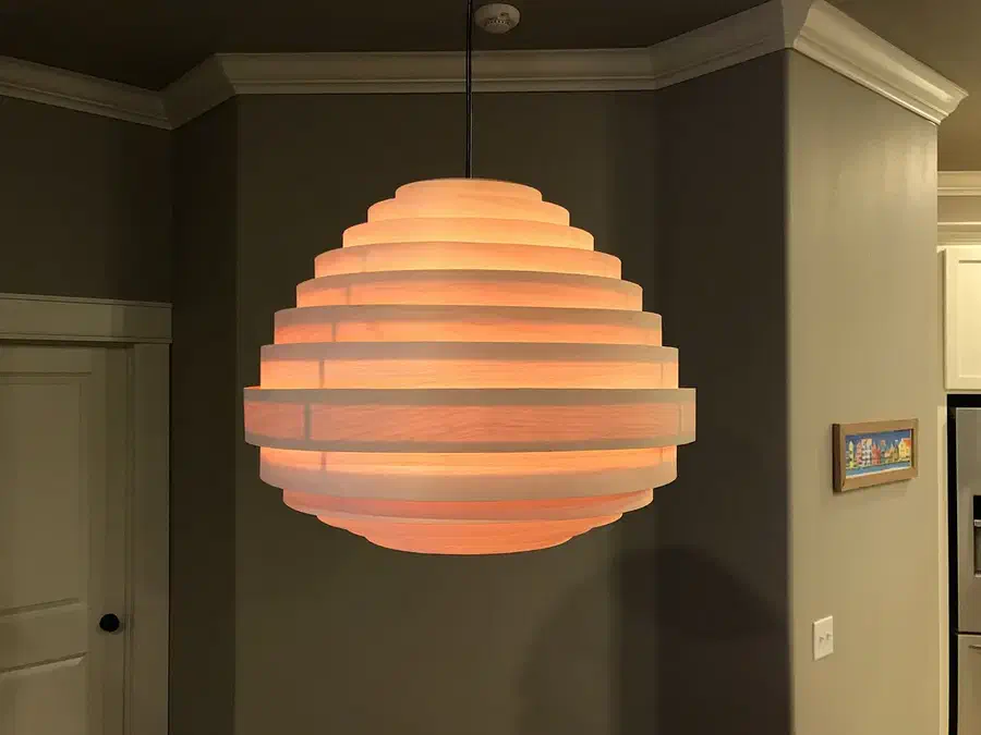

Plywood ribs let light through the gaps; maple veneer softens it around a frame. An engraved acrylic panel lights from its edge, while a walnut silhouette carries a separate bulb. Choose the shaped parts for the light you want, then add the fitting, cable and mounting hardware. These files are not electrical plans.

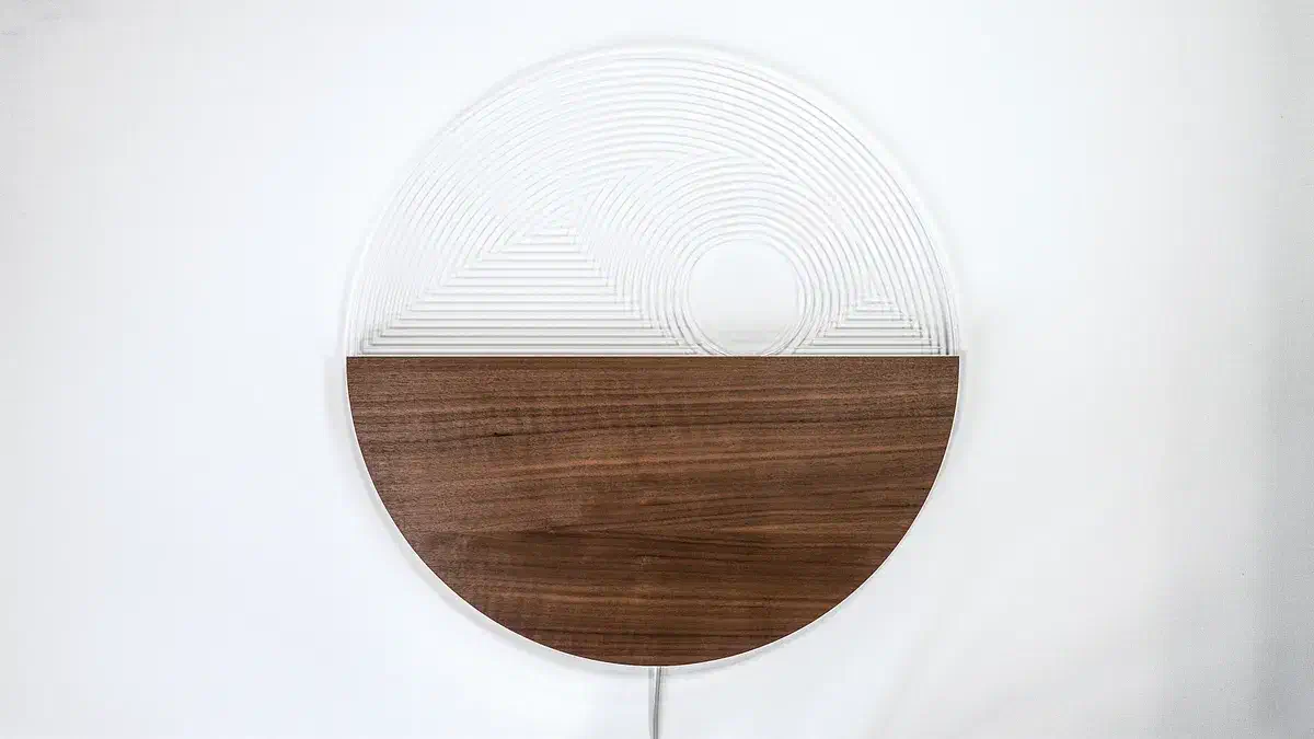

Clean engraved acrylic with a repeat pass
The wall-lamp discussion is public. An Easel account is needed to post a question.
Cristiana Felgueiras used a V-bit to engrave the acrylic in her Wall Lamp. When the first cuts left burrs, she made a second pass with exactly the same settings and no additional cutting load; that pass cleaned the grooves. Her bit had not accumulated acrylic shavings.
Comment by Cristiana Felgueiras: read the source.
From Wall Lamp by Cristiana Felgueiras.
