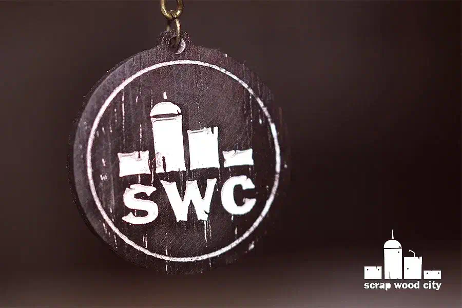

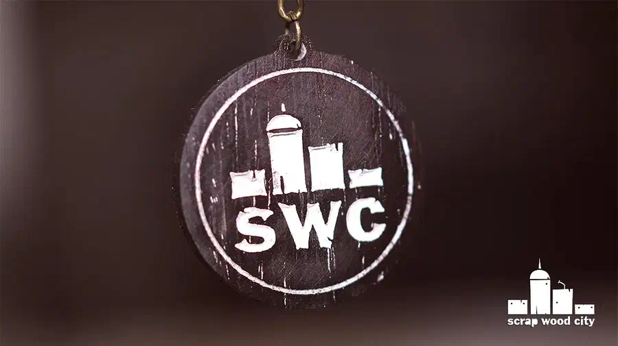

The wooden disc puts a logo on a round face; the panda follows the character’s outline. Both need a separate metal ring or chain to attach keys, and neither shared file supplies that hardware.
Scrap Wood City made this logo keychain from wenge and finished it with mineral oil. The shared Easel design includes the round fob, its attachment hole and the SWC logo. The maker used Easel Pro V-carving for the logo; replace that artwork for your own mark. The gallery’s Walnut stock label differs from the maker’s wenge description.

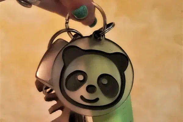

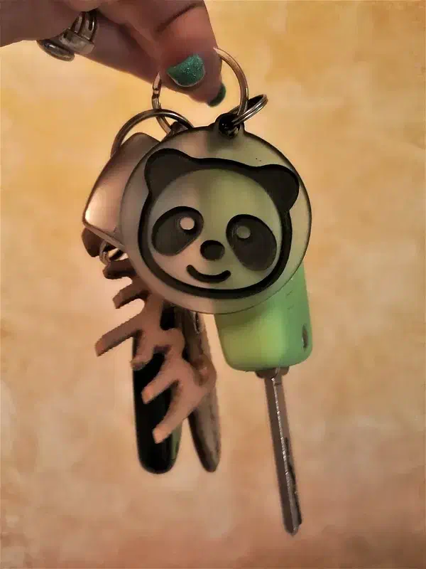

Enxuccio David carved the panda from a piece of waste plastic; the gallery lists cast acrylic. The shared design contains the shaped outline, attachment hole and recessed face details. The finished photo shows it carrying keys on a separate split ring. Paint and the ring are extra supplies, not pieces in the file.

From the panda maker’s instructions
Leave paint in the carved recesses
The panda project’s discussion is public to read; log in to post a comment.
Paint the surface, then sand the raised face
In Panda Keychains, Enxuccio David says to paint the entire piece with acrylic varnish, wait an hour, then sand from 80 to 180 grit. He explains that sanding removes paint from the outside surface while leaving it in the recessed details.
