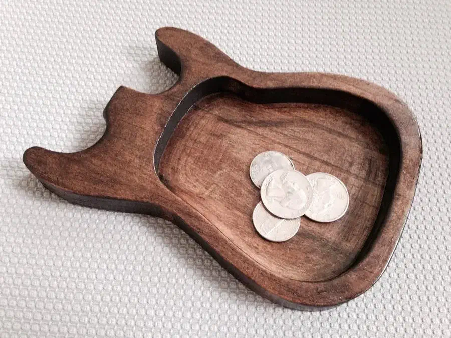

Reuse the pocket when changing the body shape
In John’s discussion, Anna Delia describes keeping the original pocket but replacing the outside outline with an acoustic-guitar shape. You can start with the recess you already like, then draw a different body around it. Leave enough wood between the new edge and the pocket instead of scaling both shapes together automatically.
Comment by Anna Delia: read the source.
From Guitar Pick Tray by John "jahsavi".
