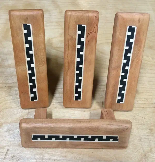

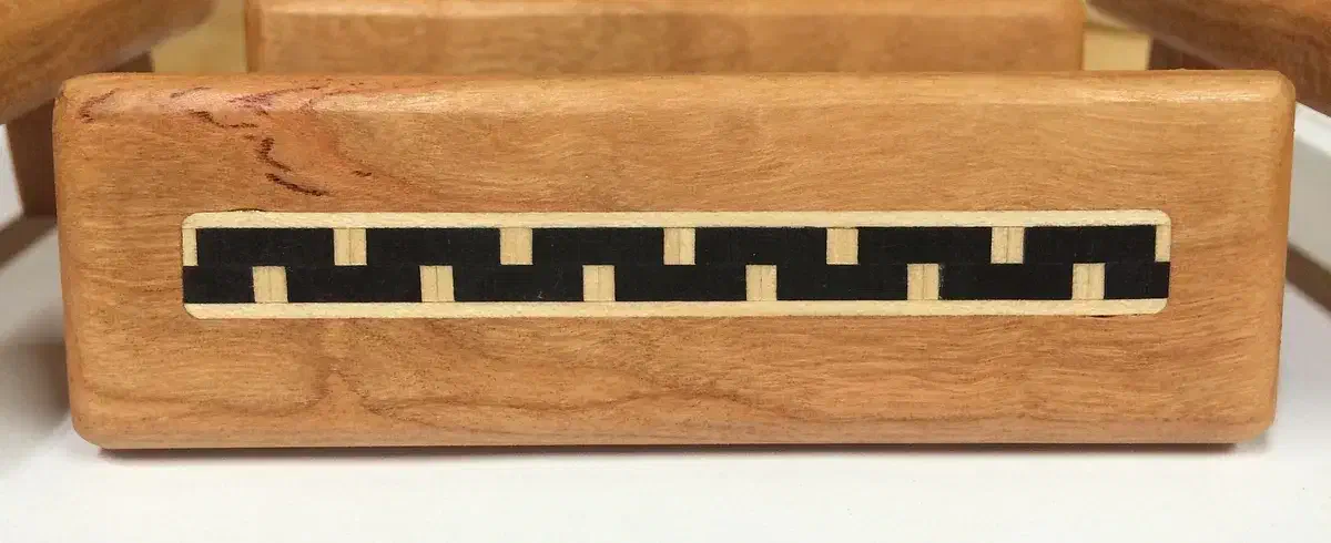

Leave the legs off while you fit the inlay
PR Smith fits each strip to its own pocket and marks the pair. With the legs still separate, the holes in the back let him push out a tight strip without prying at the patterned face. He glues the inlay before attaching the legs.

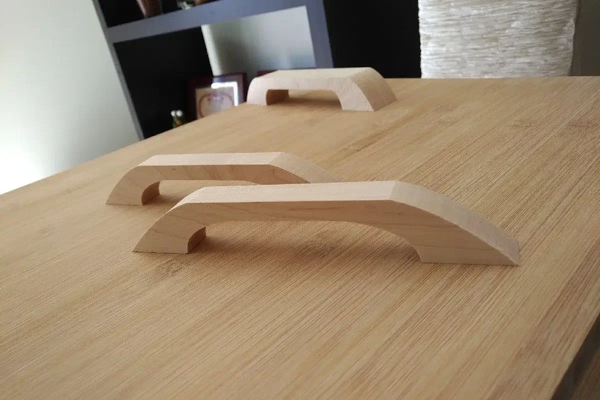

Round the grip before you drill and finish
Woodbrew rounds the carved edges with a router table or sandpaper, then sands and waxes the handles before marking the mounting holes. The curved outline gives you the shape; that extra rounding makes the part comfortable to hold.
