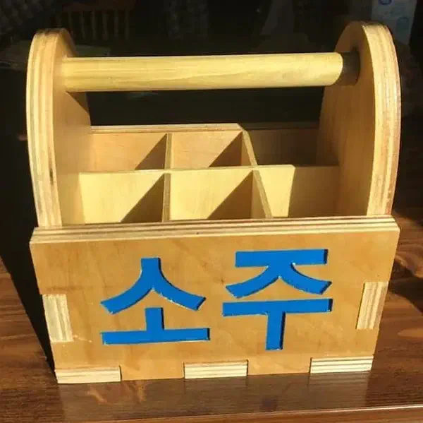

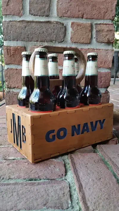

Choose a curved handle, a dowel grip or open sides
These carriers separate six bottles in different ways. The box with a dowel grip uses thin dividers; the other two use round bottle openings.

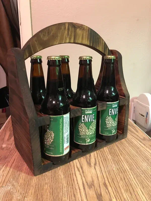

Fit the handle board and finish the box in stages
Read Ed’s handle-fitting and finishing advice in the carrier discussion. Posting a follow-up requires signing in.

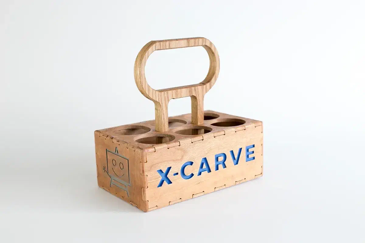

Resize handle slots without moving their centers
Ed asks makers to measure the handle board and change the slot width to match it, while keeping each slot center in place. That lets a different handle thickness fit the box without shifting the handle off its intended position. Changing the whole carrier’s scale would also change those joints.

Paint the panels before gluing the box
Ed suggests painting the separate panels first, when the faces are easy to reach. Assemble the box before rounding its corners, then glue in the handle and apply the final stain or clear finish. His sequence keeps the handle out of the way while the box edges are rounded.

Make room for the bottles you want to carry
A dowel grip suits Jason’s divided box; Ed’s separate handle fits through the bottle panel. Choose the construction you like, then set the bottle spacing and side lettering in your own Easel design.
