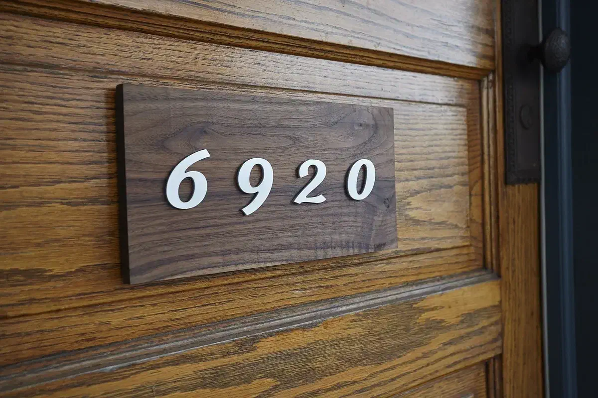

Finished walnut address marker with raised white acrylic 6920 numbers mounted beside a door Address Markerby Tait Leswing
Address Marker
White acrylic numbers stand out from a walnut board. Tait Leswing supplies two matching workpieces: shallow inside outlines for positioning on the wood and outside cuts for the acrylic numbers. Prepare the rectangular backing separately, keep the number sizes matched, then glue and mount the pieces as his illustrated instructions show.

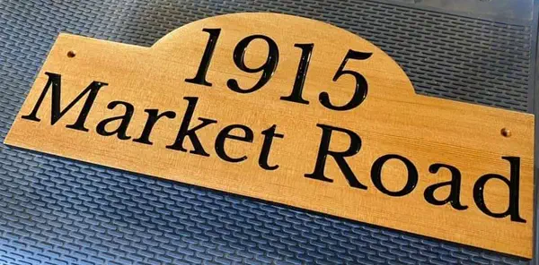

Sand away paint from the face
Ciaran Hynes paints the cut lettering with black acrylic without masking, then sands the flat face to remove the overpaint before varnishing. Try that sequence on an offcut first so you can check the contrast and keep the face flat.
Comment by Ciaran Hynes: read the source.
From House Number Sign by Ciaran Hynes.

Match the two number layouts before gluing
Tait Leswing uses inside outlines on the walnut and outside outlines for the acrylic. Keep the numbers the same size in both workpieces, dry-fit the acrylic over the wood marks, then apply a light bead of glue inside each number. His instructions use the shallow marks to hide the layout and catch excess glue.
Project notes by Tait Leswing: read the source.
